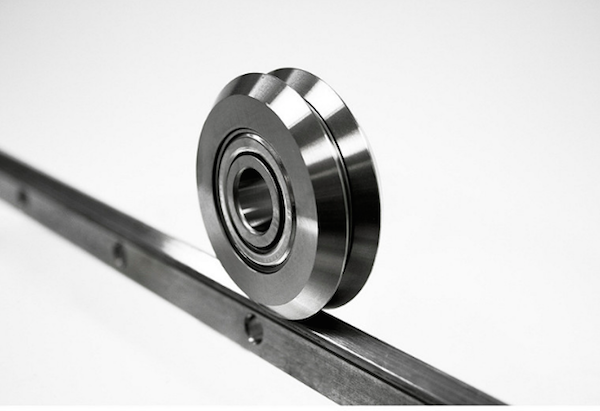

linear guide wheel
DualVee guide wheels from Bishop Wisecarver are designed with a wiping action to remove dirt and debris. (Image via Bishop-Wisecarver)
Traditional ways to reduce contamination and keep down the amount of dust and debris include metal covers and guards or barriers. However, design of linear elements themselves can make them more robust and better able to handle contaminated environments. One example are DualVee linear guide wheels from Bishop-Wisecarver. The guide wheels feature a double row angular contact ball bearing that provides load-carrying capacity in multiple directions. Their inherent design seals and shields the internal rolling elements from external contaminants, providing built-in protection without the need for additional protective measures.
