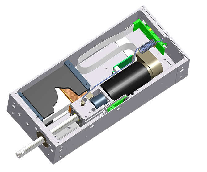

This is a LAR55 Series linear rotary actuator that accepts 48-V single-phase input to output 50-mm strokes with accuracy to within 5 µm. Peak force is to 40 N; peak torque is 0.2 to 2.5 Nm.
Unlike pneumatic actuators, SMAC actuators with moving-coil technology have fully programmable velocity, position, and force.

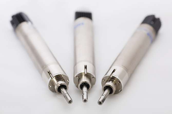

Electric cylinders such as SMAC’s CBL series actuators use moving-coil technology with force control. They have the same size and shape as comparable pneumatic actuators.

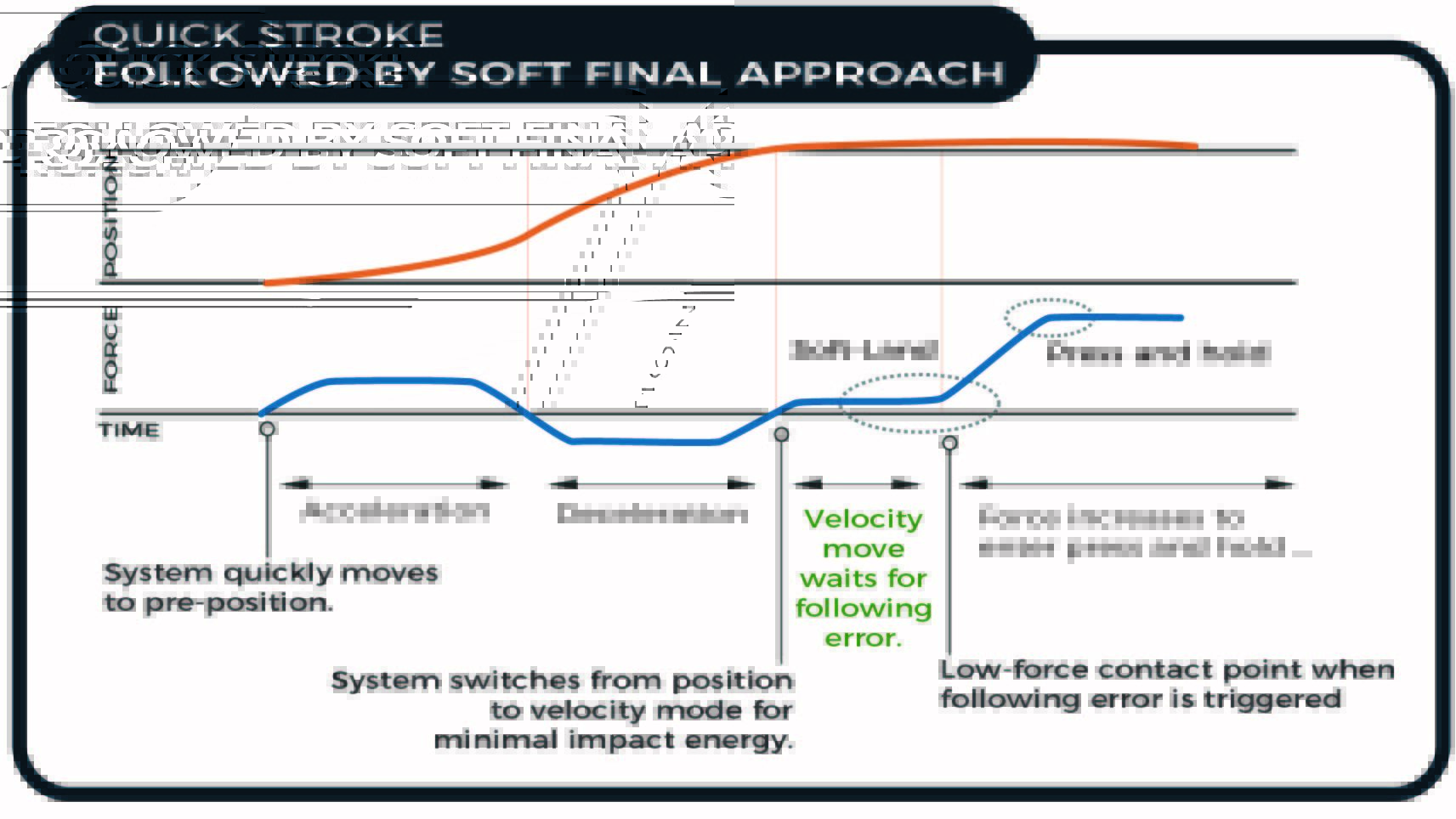

SMAC Moving Coil Actuators’ programmable velocity, position, and force means they’re capable of executing patented Soft-Land moves. During this process, the actuator rapidly approaches an object and then slows to avoid damaging it: The system executes a low-force approach in velocity mode. Upon contact with a workpiece or other reference, position error builds until a limit is reached — for actuator maintenance of position on the workpiece surface.
