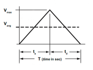

A triangular move profile has an acceleration phase and a deceleration phase, which are typically equal.

How to calculate acceleration for a triangular move profile
For a triangular move profile, acceleration is accomplished in half of the total move time and half of the total move distance. (Likewise, deceleration takes the remaining half of the move time and half of the move distance.)  So the acceleration time (ta) equals 1/2 of the total move time:how to calculate acceleration
And the acceleration distance (da) equals 1/2 of the total move distance.
Recall that acceleration is the rate of change of velocity, or velocity divided by time. In order to determine acceleration, we need to know the maximum velocity. For simplicity, we start by determining the average velocity.
Average velocity is simply the total move distance divided by the total move time:
move profile
For a triangular move profile, the maximum velocity is 2 times the average velocity, which can be expressed as:
Acceleration is the maximum velocity divided by the time to accelerate:
move profile
Substituting for vmax and using the equation for ta from above:
