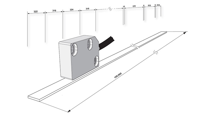

magnetic linear encoders
The maximum electrical speed is directly proportional to the encoder’s frequency response and inversely proportional to the encoder’s pulses per revolution (PPR) for rotary encoders, or pulses per distance (typically pulses per millimeter, PPM) for linear designs.

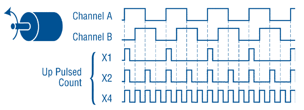

To improve resolution, incremental encoders often produce two signals in quadrature and count both the rising and falling edges of one signal — known as X2 encoding — or the rising and falling edges of both signals — known as X4 encoding. It’s important to remember that when X2 or X4 encoding is used, the encoder’s pulses per revolution (or per distance) must be multiplied by either “2” or “4” accordingly, since the electronics will have to switch two or four times as quickly.
You can see from the equations above that although increasing the pulses per revolution (or per millimeter) improves resolution, it reduces the encoder’s maximum speed.
X2 and X4 encoding can increase encoder resolution by a factor of 2 or 4, respectively. But increasing resolution decreases the maximum encoder speed.
