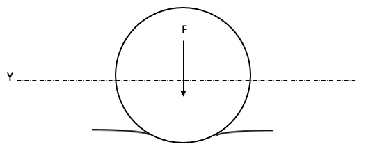

differential slip
When a load is applied to a ball, the ball and the raceway experience some deformation, resulting in an elliptical contact area.
As the ball rolls along the raceway, the velocity at any point in the contact area must equal the bearing’s angular velocity multiplied by the radius from that point to the Y axis (the axis along which the ball rolls).
