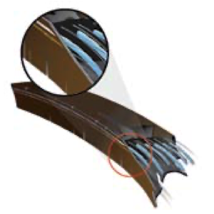

Broken V-belt
Excessive loads or improper installation can lead to broken belts.
Image credit: Gates
Broken belt
The most clear sign of accelerated belt wear or failure is a broken belt, which typically indicates that the tensile cords have been damaged. Damage to these load-carrying members can be caused by severe shock loads during operation or by using a belt that’s under-sized for the application.
Tensile cord damage can also occur if the belt is pried or rolled onto the sheave during installation. In extreme cases, foreign objects in the drive can damage the belt severely enough to cause breakage.
