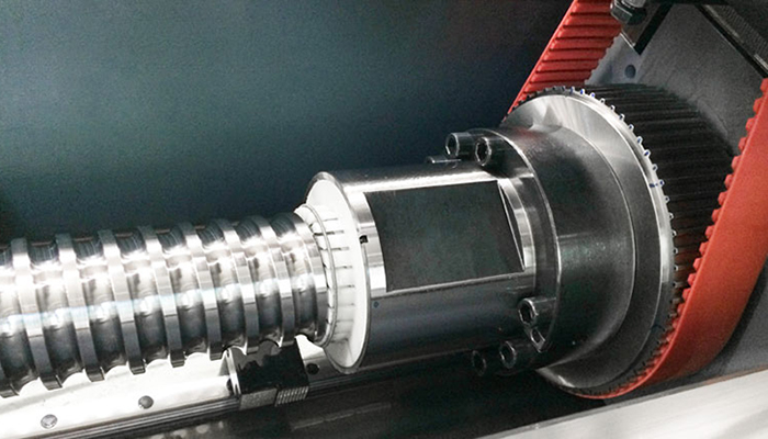

When you think of a ball screw assembly, you probably envision a screw shaft with a motor connected to one end. The motor turns the screw, and the ball nut travels along the length of the screw shaft.
An alternative setup is to hold the screw shaft stationary and rotate, or drive, the ball nut instead of the screw. Rotating ball nut assemblies (also referred to as driven nuts) were once found only as specialty solutions, cobbled together by end users or provided as custom assemblies by manufacturers. But now, virtually all mainstream ball screw manufacturers offer rotating ball nuts as standard catalog items.
Image credit: Bosch Rexroth Corp.

In a rotating ball nut assembly, the screw is stationary and the nut is rotated, typically by a motor that is attached to the nut via a belt and pulley system. Support for the ball nut is provided by a high-capacity radial bearing. Because the screw is stationary, resonance, and therefore, critical speed, are no longer limiting factors. Instead, the assembly’s maximum speed is determined by the characteristic speed, or DN value, of the ball nut.
The characteristic speed is governed in part by the speed of the balls as they travel through the nut, which depends on the ball nut design and ball return method. Typical DN values range between 60,000 and 150,000 mm/min, based on the type of ball nut. (Ball nuts with internal recirculation generally have higher DN values than ball nuts with external recirculation.)

Rotating nuts are most often used in applications that require high travel speeds over long lengths. Driving a long screw shaft, as in a traditional ball screw assembly, means dealing with high rotational inertia. Because the rotating ball nut design drives only the nut assembly — not the entire length of screw shaft — inertia is greatly reduced, which helps optimize the inertia match between the motor and the load and improves system dynamics.
Ball Nut Driven by Belt and Pulley System
Driving the ball nut (rather than the screw shaft) lowers the inertia of the moving assembly and helps to improve rigidity of the screw assembly.
Image credit: SKF Group
But driving the ball nut means the belt-pulley-motor assembly must move along the screw shaft with the nut, so the footprint of entire assembly must be taken into account when designing the surrounding structures. The moving motor assembly also requires a more complex cable management scheme. Another type of rotating ball nut solution, the hollow shaft motor, solves these problems by incorporating the ball nut directly into the motor. But this is a highly specialized solution, since the motor must be designed to accommodate the ball nut.
