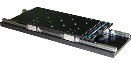

Linear stages – Stages are typically very high precision systems, meaning that high travel accuracy and minimal deflection are paramount. Even if the load is centered on the stage with little or no moment loading, dual linear rails are often used to ensure that stiffness and bearing life are maximized.
linear rails
Linear rails are often used in stages that require longer travel lengths than air bearings or crossed roller slides can provide.
Image credit: Aerotech Inc.
