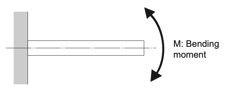

Required spline shaft diameter based on bending moment
spline shaft strength
The first step in analyzing spline shaft strength is to determine the shaft diameter necessary to withstand the applied bending moment.
The maximum applied bending moment equals the allowable bending stress multiplied by the shaft’s section modulus:
M = bending moment (N*mm)
σ = maximum allowable bending stress (N/mm2)
Z = section modulus (mm3)
Most shaft manufacturers provide the section modulus for each shaft type and diameter, so by solving this equation for the section modulus, Z, the appropriate shaft diameter to withstand the applied bending moment can be selected from the manufacturer’s catalog.
