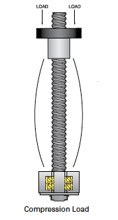

The application’s maximum axial load must also be checked against the load that can be supported by the screw shaft, commonly referred to as the buckling strength or column strength. In horizontal applications, where the load is supported by a low-friction linear guide, the weight of the moved load contributes only a small amount to the axial load on the screw. But in vertical applications, where gravity causes the screw shaft to see the full force of the load, buckling can become a significant factor in lead screw sizing.
Fb = maximum compressive (buckling) load (N)
fb = factor based on end support bearings
dr = root diameter of screw (mm)
Lc = unsupported length of screw (mm)

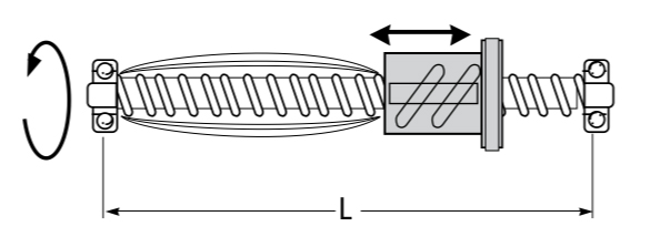

Like ball screws, lead screws have an inherent maximum rotational speed, which is referred to as the critical speed. The critical speed is based on the natural frequency of the screw, and if it is exceeded, severe vibrations can develop and damage the screw assembly.
The determining factors for the critical speed of a screw shaft are its length, diameter, and end fixity. (Note that mounting orientation — vertical or horizontal — does not affect critical speed.) While the length of the screw is typically set by the application requirements, the critical speed for a given screw length can be increased by choosing a larger diameter screw or by using a more rigid end bearing arrangement.
nc = critical speed (rpm)
fc = factor based on end support bearings
