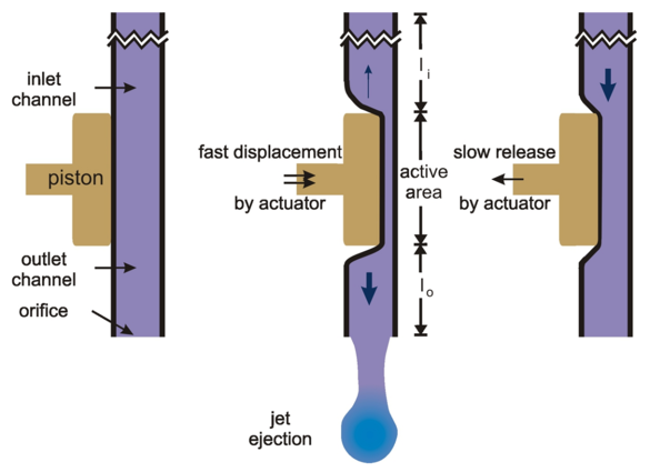

Microliter and nanoliter dispensing
Diaphragm pumps or valves driven by piezo actuators are a common solution when microliter or nanoliter volumes need to be dispensed. The displacement of the piezo actuator determines the dispensing volume, and the actuator’s operating frequency controls the flow rate. Bending actuators and piezo tubes are often used in these applications, due to their compact size and ability to be manufactured in a variety of forms.
One example of microliter or nanoliter dispensing is an implantable drug-delivery pump, which requires extremely accurate motion for proper dispensing and has a size constraint that few other technologies can meet. Industrial applications include large-format inkjet printers and printed circuit board manufacturing.
piezo actuators
A piezo actuator controls the flow of ink for an industrial inkjet printer, producing sub-nanoliter drop sizes.
Image credit: BioFluidix GmbH
