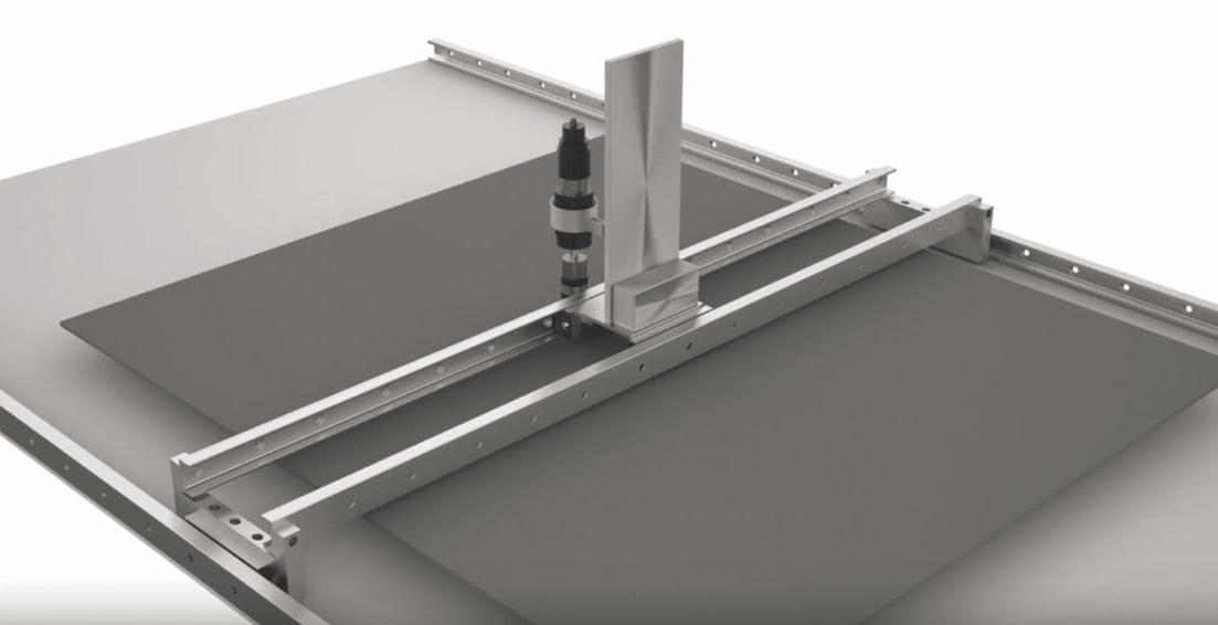

Racking is the common name for a condition in which the parallel X axes in a gantry system don’t move in synchronization, causing the X and Y axes to lose orthogonality. Racking often results in binding of the X axes and potentially damaging forces to both the X and Y axes.
Any time two linear guides are mounted and operated in parallel, they require a certain tolerance in parallelism, flatness, and straightness to avoid overloading the bearings on one or both guides. In gantry systems, where the X axes tend to be spaced far apart (due to long travel on the Y axis), the mounting and parallelism of the X axes becomes even more critical, with angular errors being amplified over long distances.
Different guide technologies require varying levels of precision for parallelism, flatness and straightness. In gantry applications, the best linear guide technology for the parallel X axes is typically the one that offers the most “forgiveness” in mounting and alignment errors while still providing the required load capacity and stiffness.
gantry systems
To help prevent racking in gantry systems, ensure sufficient parallelism between the X-axis guides and small flatness deviations between bearings.

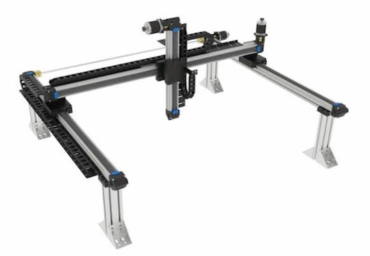

Recirculating ball or roller profiled rail guides typically provide the highest load capacity and stiffness of all linear guide technologies, but when used in a parallel configuration, they require very precise mounting height and parallelism tolerances to avoid binding. Some manufacturers offer “self-aligning” versions of recirculating ball bearings that are able to compensate for some misalignment, although rigidity and load capacity may be reduced.
On the other hand, guide wheels that run on precision tracks require less accuracy in mounting and alignment than profiled rail guides. They can even be mounted to moderately inaccurate surfaces without causing running issues such as chattering and binding, even when two tracks are used in parallel.
gantry systems
This gantry system uses wheel-based linear guides, which can be mounted on imprecise surfaces without causing issues with running characteristics or binding.
Image credit: Bishop-Wisecarver
