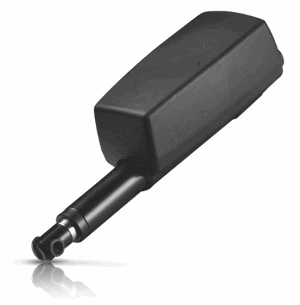

thrust actuator
Thrust actuators are often supplied with integrated motor and control hardware, with options ranging from a simple 12V DC motor and limit switches, to full servo units with motor, drive, and controller.
Image credit: LINAK
Thrust force is transmitted to the load by a rod that extends and retracts, guided by a plain bushing, from the actuator body. Typical thrust actuators don’t include linear guides, since their design is not inherent to carrying loads — only pushing, pulling, or holding them. If support or guiding of the load is required, rails, shafts, or tracks, independent of the actuator, are used.

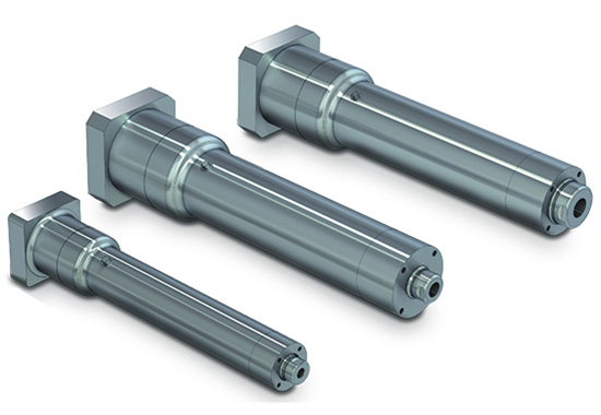

The housing of a thrust actuator is typically a fully-enclosed design that encapsulates the mechanical and electrical components. With a seal added to the thrust rod, it’s often possible for these actuators to achieve high IP ratings, making them ideal for applications where the actuator is exposed to fine particles, liquids, or washdown conditions. And manufacturers typically provide material options for the housing, including platings and coatings to provide corrosion-resistance to a wide range of chemicals and environments.
rod style actuator
One of the unique benefits of rod style actuators is their ability to be constructed with features that make them suitable for challenging environmental conditions and requirements. For example, the ERD hygienic actuators from Tolomatic are constructed from stainless steel and have an IP69K rating (suitable for steam and high-pressure washdown).
