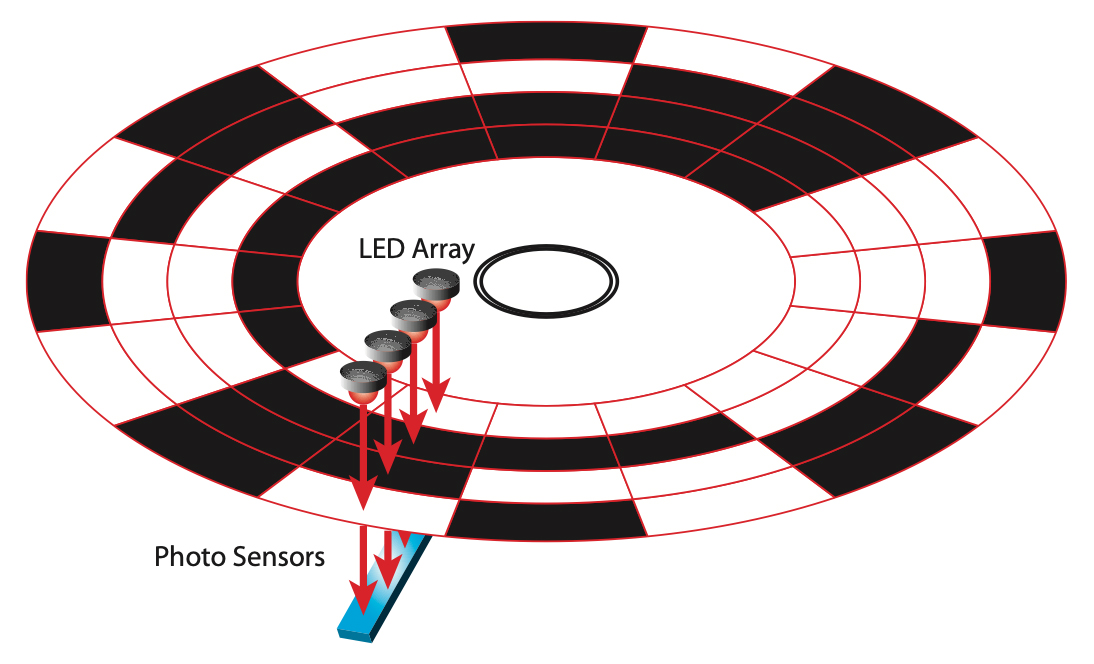

For most absolute rotary encoders, resolution is defined in terms of bits, or binary words. The encoder disk is patterned with concentric tracks around its circumference (and a corresponding number of sensors — one for each track), and each track represents one bit of resolution.
To convert bits of resolution into the number of positions the encoder can detect with each shaft revolution, simply raise the number 2 to the power of the number of bits. For example, an 8 bit encoder would be able to measure 256 positions for each shaft revolution (28), and a 16 bit encoder would be able to measure 65,536 positions per revolution (216).

Each concentric track on the encoder disk represents one bit of resolution. Note that each track, starting from the inside of the disk, has double the number of light-and-dark bands than the previous track. The encoder shown here has 4 tracks, so has 4 bits of resolution and can measure 16 positions (24) for each rotation of the encoder.

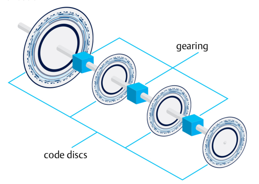

Another type of absolute rotary encoder — known as a multi-turn encoder — can track not only the position within one revolution, but also the number of revolutions the encoder makes, up to 4096 turns on typical designs. Multi-turn encoders come in several variations, including those that use multiple disks connected by gears and those that use electronic counters to track the number of turns. For those that use multiple, geared disks, the encoder’s total resolution is the sum of the resolution for all disks. So a multi-turn encoder that has a primary disk with 10 bits of resolution and a secondary disk with 8 bits of output will have a total resolution of 18 bits and will be able to measure 262,144 unique position values (218).

Some multi-turn encoders use multiple encoder disks connected by gears.
