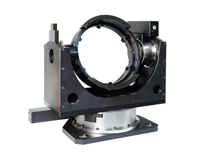

Gimbals are also referred to as “gimbal mounts” because they’re often used for mounting optics or sensors.
Image credit: Newport Corporation
In simple terms, a gimbal is a pivoting platform that allows an object to rotate around one or more axes. They’re often found in photography and videography applications to stabilize cameras, as well as in navigation systems for ships. In these applications, two or more gimbals are mounted together with orthogonal axes (axes mounted 90 degrees to each other), and the supported object remains stationary while the gimbals rotate around it to counter any rolling, pitching, or yawing motions that occur.
In industrial applications, gimbals are typically classified as a type of rotary stage and are also referred to as “gimbal mounts,” since they’re commonly used for mounting mirrors, sensors, or other direction-sensitive equipment. Gimbal axes are driven with servo, stepper, or even piezo or voice coil motors. For precise positioning, they operate in a closed-loop system with a feedback device — typically a high-resolution rotary encoder — on each axis.

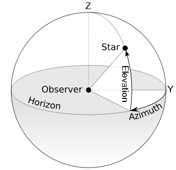

Gimbal movements are based on the horizontal coordinates of azimuth and elevation, with some multi-axis gimbal stages also including a third axis whose movement is referred to as roll. Azimuth and elevation are most easily visualized by thinking of an object’s position relative to the horizon, as shown below.
gimbal
Azimuth movements occur around the Z (vertical) axis, and elevation movements occur around the Y axis.
Azimuth is the position around the horizon, measured from a reference point such as true north or true south. Azimuth movements occur around the Z (vertical) axis.
Elevation is the object’s distance above or below the horizon (also referred to as altitude in astronomy and aerospace applications). Elevation movements occur around the Y axis.
Roll movements occur around the X axis as it rotates with the Y and Z axes.
