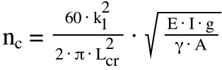

How to calculate ball screw critical speed
The critical speed of a shaft depends on its mass, length and diameter, the amount of deflection it experiences, and the end support method (type of end bearings).
The equation for critical speed of a ball screw is:
nc = critical speed (rpm)
k1 = factor depending on end bearing arrangement
Lcr = unsupported length of screw shaft (mm)
E = modulus of elasticity of screw shaft (N/mm2)
I = planar moment of inertia (mm4)
g = acceleration due to gravity (mm/s2)
γ = specific weight of screw shaft (N/mm3)
A = cross-sectional area of screw shaft (mm2)
It’s important to remember that if the ball nut is preloaded, the unsupported length (Lcr) is based on the greatest distance between the ball nut and the end of the screw that will occur in operation. For non-preloaded ball nuts, the unsupported length is simply the length between bearings (l).
